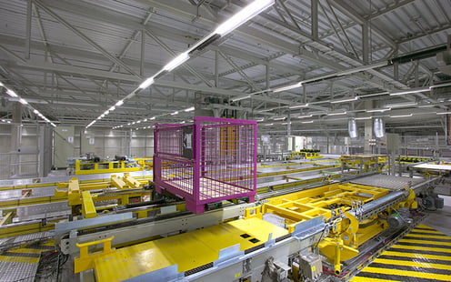

In order to be constantly competitive in the automotive industry, the central logistics and parts delivery center must always be as up to date as possible. As part of the most recent expansion, or rather refurbishment, of the Dynamics Center, the computers processing the flow of material were replaced with a Simatic S7-400 master controller. In addition, BMW also requested a new software solution for the process control level and operation of the control panels, of which there are currently 50. zenon came into play here. zenon from COPA-DATA displays all processes – from the receipt of goods, through internal movement, to dispatch. The solution thus enables the people operating it to know where a replacement part or accessory is at any time.
Two methods of transport, one solution
There are a total of 325 chain conveyors on the ground floor. The containers to be transported are placed on or transferred to defined locations on the chain conveyor by means of fork lift trucks. 11 lifting stations, 16 lifting tables, 6 rotary tables and 19 telescopic inverters connect the chain conveyor with the elements of the electric pallet conveyor. They also form the interface between the two levels and methods of transport. The telescopic inverters and lifter bring the skeleton containers with the objects being transported to the upper level, where they are transported by the electric pallet conveyor passed up to 63 four-way points and 7 rotary points to their destination. The electric pallet conveyor is the heart of the internal transport system and serves to bridge the very long distances in the Dynamics Center. It connects the areas for receipt of goods with pre-packaging, storage, order consolidation and final packaging. The electric pallet conveyor is approximately 6 meters above the facility floor. The conveyor system is 2,650 meters long in total. zenon visualizes the complete conveyor technology on both levels.
