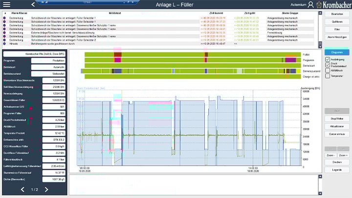

Alarms are clearly displayed and can be processed centrally.

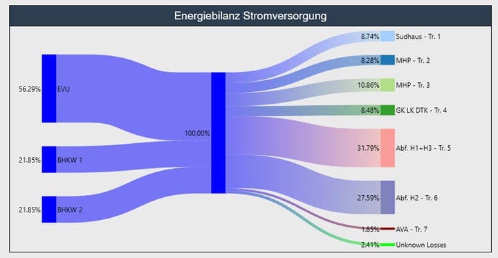

The Sankey diagram shows all energy management data in a clear energy footprint.

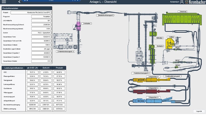

zenon clearly displays the can filling line L and all its KPIs.
